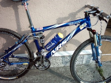

Bar Ends: (Rogi) Ritchey WCS Classic - 103
Bar Plugs: (Korki kierownicy) Lizard Skins Plastic - 4
Brake (Front): (Hamulec przedni) Shimano XTR BR-M951, with Bolts, Pads and Noodles - 201
Brake (Rear): (Hamulec tylny) Shimano XTR BR-M951, with Bolts, Pads and Noodles - 202
Cables and Outer Casings (Shift): (Linki i pancerze przerzutek) Shimano XTR SIS M950 Grey - 84
Cables and Outer Casings (Brake): (Linki i pancerze hamulców) Shimano XTR ATB M950 Grey - 113
Cassette: (Kaseta) Shimano XTR CS-M953 ap 12-14-16-18-20-23-26-30-34 - 249
Chain: (Łańcuch) Shimano Dura-Ace/XTR CN-7701 110 links, with Wippermann Connex Link - 276
Crankset: (Mechanizm korbowy) … - 897
- Bottom Bracket: (Suport) Shimano XTR BB-M952 116x75, with Spacers 3.5+3.5 - 217
- Arms, Spider and Chainrings: (Ramiona, Pająk i Tarcze) Shimano XTR FC-M952 - 680
Derailleur (Front): (Przerzutka przednia) Shimano XTR FD-M952 34.9 Top Swing, Top Pull - 110
Derailleur (Rear): (Przerzutka tylna) Shimano XTR RD-M953 SGS Rapid-Rise, with Boot Cable Protectors - 239
Fork: (Widelec) Rock Shox SID SL 2002 80 mm, 210 mm Steerer Tube, blue - 1344
Frame: (Rama) Giant XTC NRS Team 2003 M 18.5'', with SID Rear Shock - 2652
Grips: (Chwyty kierownicy) Lizard Skins Logo Dual Compound 130 mm, black/gray - 97
Handlebar: (Kierownica) Ritchey WCS Classic 31.8x580 - 146
Headset: (Stery) Ritchey WCS Classic Press-Fit 1.125 inch, 44 mm, with Ti Bolt and Steel Washer - 110
Pedals: (Pedały) PD-M959 - 346
Pivots (Front): (Piwoty przód) Rock Shox Ti M8x1.25, with Washers - 10
Pivots (Rear): (Piwoty tył) Ti M10x1 - 10
Seat: (Siodło) Selle Italia Flite Titanium Gel, red - 277
Seatpost: (Sztyca) Ritchey Pro Classic 30.9x400 - 265
Seatpost Clamp: (Zacisk sztycy) Giant, with M6x25 Ti Bolt and Steel Washer - 27
Shifter/Brake Levers: (Klamkomanetki) ST-M952 3x9 - 393
Skewer (Front): (Zacisk koła przedniego) Shimano XTR M950 - 56
Skewer (Rear): (Zacisk koła tylnego) Shimano XTR M950 - 62
Spacers: (Podkładki pod mostek) Pro Aluminium 5, 10 and 20 mm - 22
Stem: (Mostek) Ritchey WCS Classic 100x31.6 - 111
Tire (Front): (Opona przednia) Michelin Wildgripper Front S Tubeless 26x2.1, black/green - 803
Tire (Rear): (Opona tylna) Michelin Wildgripper XL S Tubeless 26x2.1, black/green - 856
Tube (Front): (Dętka przednia) Continental MTB 26 Lite 47/62-559 S42 - 128
Tube (Rear): (Dętka tylna) Continental MTB 26 Lite 47/62-559 S42 - 127
Wheel Front: (Koło przednie) … - 714
- Hub: (Piasta) Shimano XTR HB-M950 32h - 133,5
- Rim: (Obręcz) Mavic X517 17-558 32h, black - 405
- Spokes: (Szprychy) DT Revolution 2.0-1.5-2.0 32x264, black - 141
- Nipples: (Nyple) DT Pro Lock Alu 12x2.0 32 pcs, black - 10,5
- Rim tape: (Opaska) Continental Easy Tape 22-559 - 24
Wheel Rear: (Kolo tylne) … - 889
- Hub: (Piasta) Shimano XTR FH-M950 32h - 307
- Rim: (Obręcz) Mavic X517 17-558 32h, black - 409
- Spokes: (Szprychy) DT Revolution 2.0-1.5-2.0 16x262 16x264, black - 140,5
- Rim tape: (Opaska) Continental Easy Tape 22-559 - 22
Misc Option: (Inne) … - 91
- Bottle Cage Bolts: (Śruby koszyka na bidon) Pro-Bolt Al 7075 (PA9) M5x16 4 pcs with Washers, black - 5
- Chainstay Guard: (Osłona łańcucha) Lizard Skins Jumbo, splitted: 19+6 cm, black - 16
- Rapidfire Remote Shifter: (Manetka zmiany biegów na róg) Shimano XTR SL-SS95 R with Cable Set - 64
- Strips: (Tasiemki samozaciskowe) Nylon - 6
Overall: 12014 g.
